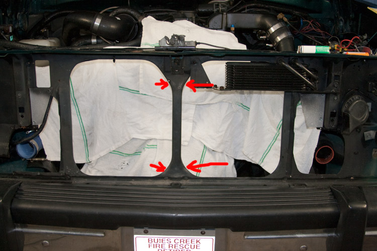

Now we need to cut the center radiator support column so there will be room to withdraw the cam and gear from the block.
The column is made from two layers of sheet metal. One nested in the other and spot-welded in place.
My thinking was to try to not cut things so much that reassembly would be a mess. With that . . .
Be sure to cover the face of the engine so you don't get any metal shards in anything!
- I cut the top of the column just above where it Y's out. I only cut the outer flanges so that I could bend the thing to do my work, and then bend it back when done.
- I cut the bottom of the column about an inch above where it meets the bottom of the radiator support assembly.
- DON'T bend the column out of the way just yet.

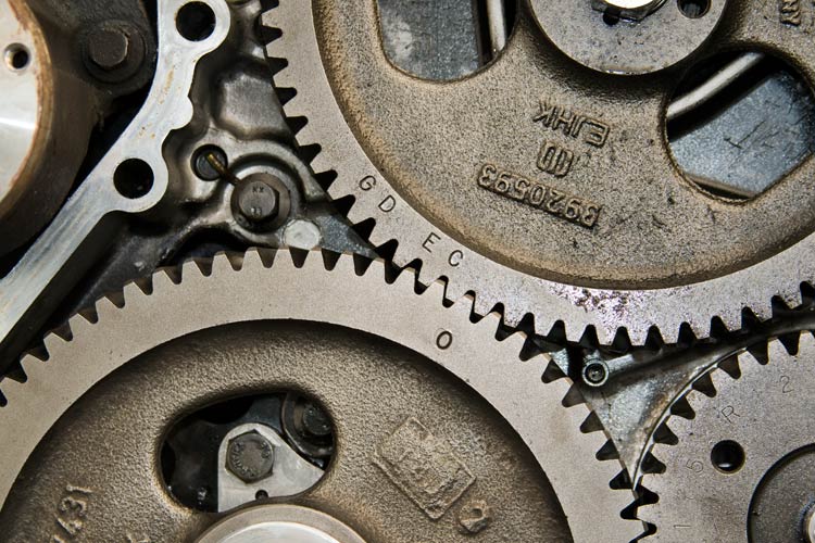

- Make note of the crank/cam indexing for reassembly.
- Make note of the cam/IP indexing for reassembly.
- NOTE: Stock/OEM injection pump timing has the "O" of the camshaft gear go to the "E" of the injection pump gear.
Here, you can see I've got mine advanced two teeth.

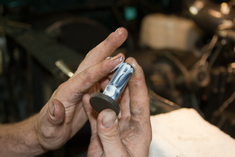

With the Trough in place we can now start removing the lifters.
- Starting with cylinder no1, remove the hair-band from the Wooden Post holding the intake valve's lifter. The lifter should drop into the Trough. If it doesn't, you can help it with the Wooden Post.
- You may need to gently rock the Trough a little to get the lifter to fall over.
- Remove the lifter from the Trough with your Hook-Tool. If you have difficulty with the coat-hanger, just slide the Trough out of the block enough to fetch it. Don't bang the freeze-plug sliding the Trough back in.
- If you plan to reuse your lifters, store them in the order of removal so you'll know which goes where.
- Continue till all the lifters are removed.

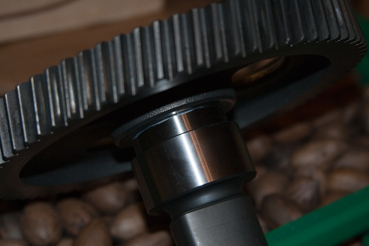

- Now, if you're gonna swap in a new camshaft or need to replace the cam gear, the two need to be separated.
- Some may suggest simply smacking things with a hammer. I used a press to do the work. The two are machined such that there's an Interference Fit so the gear's on there, but not like welded on there.
- Be sure to keep up with the key that locks the two as you'll need it when putting it all back together.
- Clean both the gear and cam snout being sure to remove any burrs.
In this "How-To", it is assumed you're swapping in a new camshaft. If you plan on reusing your original camshaft, you'd do well to fully inspect it so as to be sure it's worth putting back in.

- Make sure the gear's clean so you don't stink-up Momma's kitchen!
- Place the gear in the center of the oven. Set it so the face of the gear looks up (Timing marks up).
- Heat the gear for 45 minutes. Never allow the oven temperature to go above 350*F.

- Check the lifters socket, stem and face for excessive wear, cracks and other damage.
- The minimum lifter stem diameter is 0.627" (15.925 mm). If the stem wear exceeds that mentioned, replace the lifter.
I've always believed that if you replace the camshaft, you need to be sure the lifter faces are absolutely pristine. If not, resurface or replace the lifters. As with the camshaft . . .
Lifter face pitting criteria
- A single pit can not be greater than 0.078" (2 mm).
- Interconnection of pits is not acceptable.
- Total pits when added together should not exceed 0.236" (6 mm) diameter or a total of 4% of the lifter face.
- No pitting is acceptable on the edges of the wear face of the lifter.
NOTE: In the case of abnormal wear or pitting (excluding excessive stem or socket wear), most lifters can be salvaged by resurfacing the face. Check with your favorite cam specialist.
Excessive pitting on the left, scoring on the right. Both fail but can be successfully resurfaced.

- BE SURE THE TIMING MARKS ARE ALIGNED.

- Reassemble the radiator's center support brace. I used a piece of 1/8" thick sheet aluminum to make a strap that nests inside the original brace (engine side). I had it flair out like the brace at both the top and bottom. I then riveted it in place. Works just fine.
- Reinstall the radiator.
- Reinstall the inter-cooler.
- Reinstall the engine's cooling fan along with it's shroud. I put a booger of anti-seize on the fan clutch's hub threads to make it easier to remove in the future.
- Reinstall the front of the truck.
