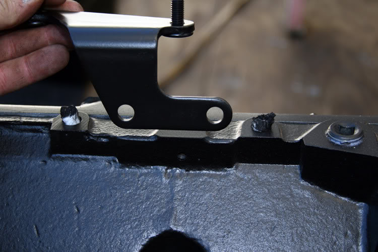

You'll find the boss, cast into the head for our throttle linkage assembly mount has not been milled and drilled. No big whoop.
Look at your old head and locate the mounting bracket holes to the new head. Drill and tap. Good to go.
