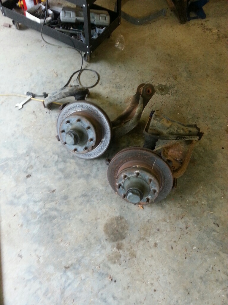

That lowering trick uses a van control arm. The 4000# pickup arm won't take a light-duty balljoint. I tried that.... the hole to seat it in is way too big.
That still doesn't address the steering linkage. It's made from thicker rod, and its dipped to clear the oil pan. The steering knuckles need to be reamed out for the larger TREs.
There's nothing scary or detrimental about going 8lug. The only mod I had to do was drill out the two LCA bolt holes below the crossmember - the bolts are bigger. Everything else bolts up.

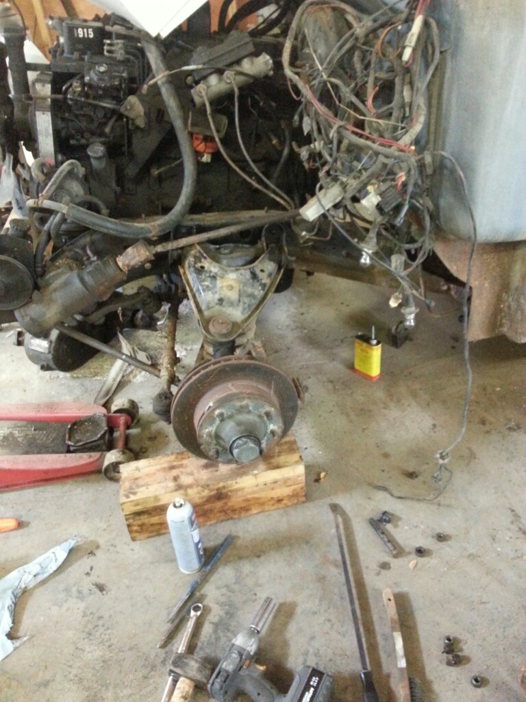

here is my 1/2 ton cummins i have been daily driving it for 4 years now in the spring summer and fall in ontario all i did for springs was a set of heavy duty springs from rockauto the 1/2 ton rear end will hold up fine biggest problem is getting the u joints/ drive shaft figured out i have recently gone to a ford 8.8 under the truck and did a 3/6 drop which i cant find picture of it on my pc and truck is in storage right now if you have any question feel free to ask i try to come on the forums every couple days

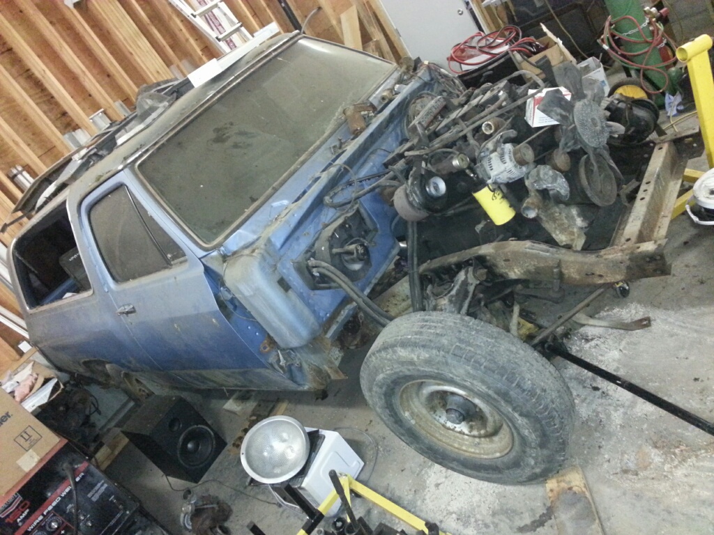

I have aspirations of towing with mine, and a glut of 8-lug wheels. Nevermind that my cummins came with a D250 wrapped around it already. One thing on the cummins cab... the firewall/tunnel seam is trimmed back. Looks factory. As a precaution, I trimmed it back extra on my RC. I'm not at final fit stage so I don't know if it makes a difference.
What did you encounter for draglink clearance?
no drag link problems at all everything was pretty well a straight forward swap except had a really tiny trans tunnel do to it being a auto 2wd 1/2 ton i ended up cutting the tunnel out of the doner here are a bunch more picture of from when i did the swap https://www.dieseltruckresource.com/...ersion-303540/
