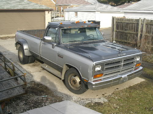

My truck... 1990 D350 (Nonintercooled)

I'm with MoparMarv and am the buddy that he's helping with the head gasket, KDP, etc, etc. We've got the head off and it's at the machine shop. While we wait for positive test results and a possible redeck I'd like to do something about my injectors.
They all looked pretty bad and two were really wet like a possible leak. The truck was putting out white smoke all the time which is why we're replacing the head gasket in the first place. All the same since we're here and doing all this work I figure it'll behoove me to do something about cleaning or changing the injectors.
