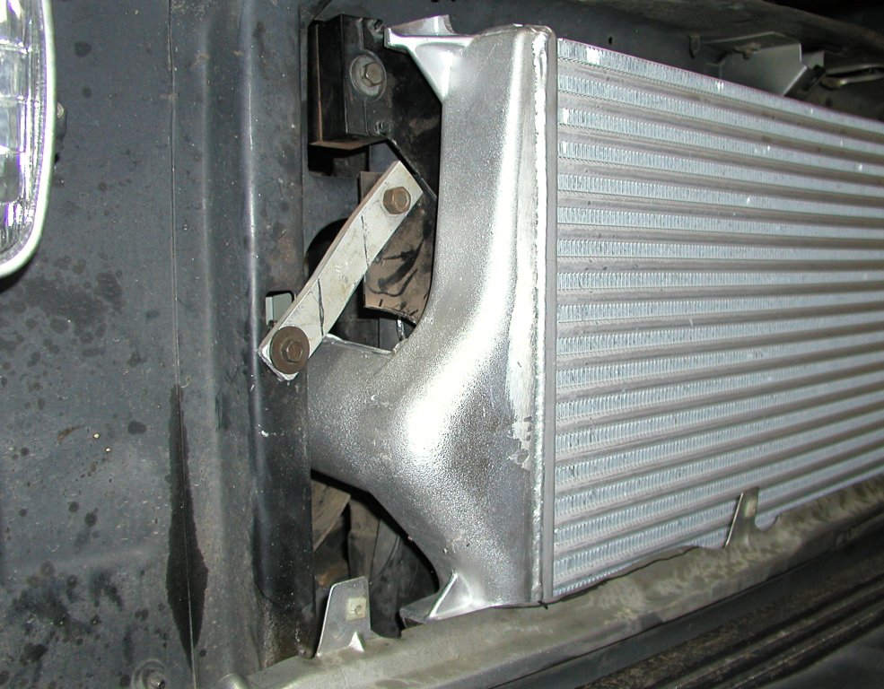

One Way to Install a Powerstroke Intercooler
There are three tricks to getting this done: 1) the condenser is rescessed about an inch behind the front face of the core support mounting surface. 2) The IC is mounted as high as possible. And 3) The original lower IC mounts must be removed completely. The grill seems designed to kinda curve more outward towards the top, so there's a little more room behind it higher up. Mine is actually touching the IC and pulled in a half inch on each bottom corner with the mounting screws, so it's not exactly right, as it should be. If I had been able grind the original lower mounts flush with the support, the valence triming would have been really trivial if necessary at all and it would have went on perfectly. But it's close enough. Someone witha smaller grinder or plasma cutter could do this easily.
There is one "gotcha to look out for. The top passenger side mount is extremely close to the AC condeser line outlet. This required fabbing a braket with the nut welded on. The is no way to get a wrench in there. Also, you can do it without removing the bumper, but it's tricky. There is enough room to slide the condernser and the IC in and out together at the same time, but not seperately. That might be possible but probably would have required removing more of the condenser mounting bracket than I was comfortable with. I had to bend the bottom edge of the battery tray in a half inch or so as to not abrade the hump hose. No biggie.
So here it is, blow, by blow.

The IC must be tucked in this tight. There is about a quarter inch shaved off that back edge and it is right up against the middle support brace.
http://72.19.150.167/PhotoAlbum/Cars/Pics/CTD_105.jpg

It cools alot better. I only had it out a couple times today, and EGT seems to be averaging around 100 degrees cooler. But I lost about 5lbs boost. Guess I'm in the market for a compressor upgrade now. It should be able to sustain some really heavy towing. I'm not too impressed by engines that can only generate big numbers for a short period of time. It's ready for some real fuel and serious work one of these days.

Thanks, it was supposed to be for a 2000 7.3. At least that's what the eBay ad said. But I don't trust much I see on eBay. Looks just like Wanna's, judging by comparing the pics.
Seems the boost issue is pretty much only at max boost. Normal boost levels seem about the same, with a bit more lag. It obviously takes alot more air to fill that thing up now. But it won't go much over 20lbs. under full load anymore, where before I was at around 25. It's a good example of how the stock package was a really well matched setup. Now I have a much better intake tract, but not enough air (or fuel! ) for it.

That's very nice! Way to think outside the box, Ace! I never thought about putting the condenser behind the IC. The only drawback i can think of is the A/C might not work well while pulling heavy up a hill in hot weather. I think I'm gonna redo mine sometime this summer.

I thought of that too. But those situations are a small amount of time compared to most normal daily driving, and it won't hurt anything, so I figured, what the heck. That was the only way I could see to do it without major surgery.
Besides, what's the priority: Lower EGT or lower AC temp?
Oh, and I noticed on a hard top gear run going home on the interstate today it pushed up to 23psi. So looks like I only lost a couple pounds of max boost. It does seem to like running on cooler air better in any case, though.

Yes, the hood latching is not affected at all, and I do have the 3" tube connecting the turbo to the IC. It's not really much to see, just a straight piece of 3" pipe replacing the stocker.
