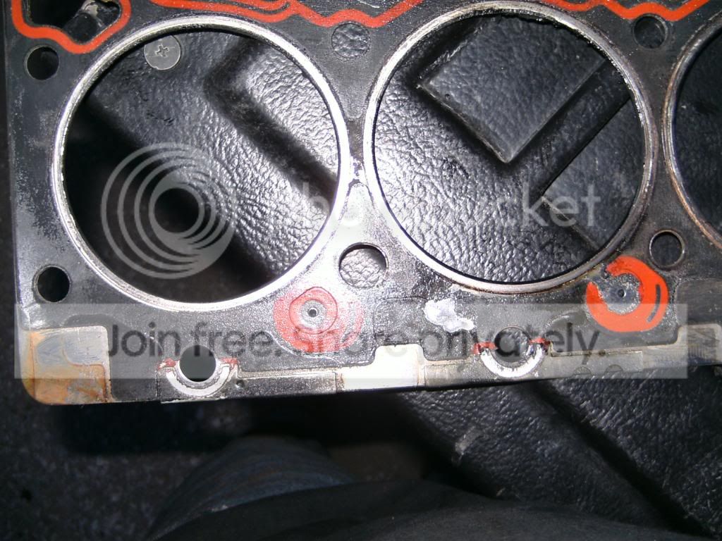

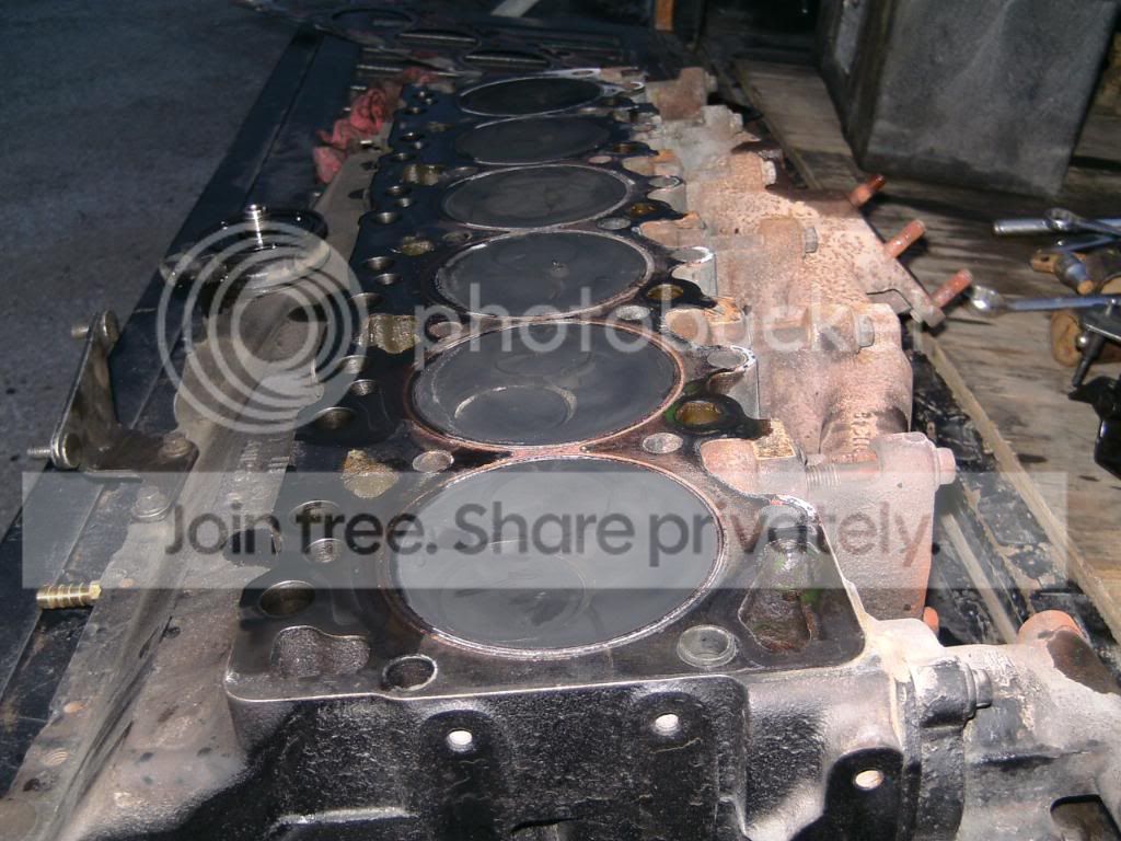

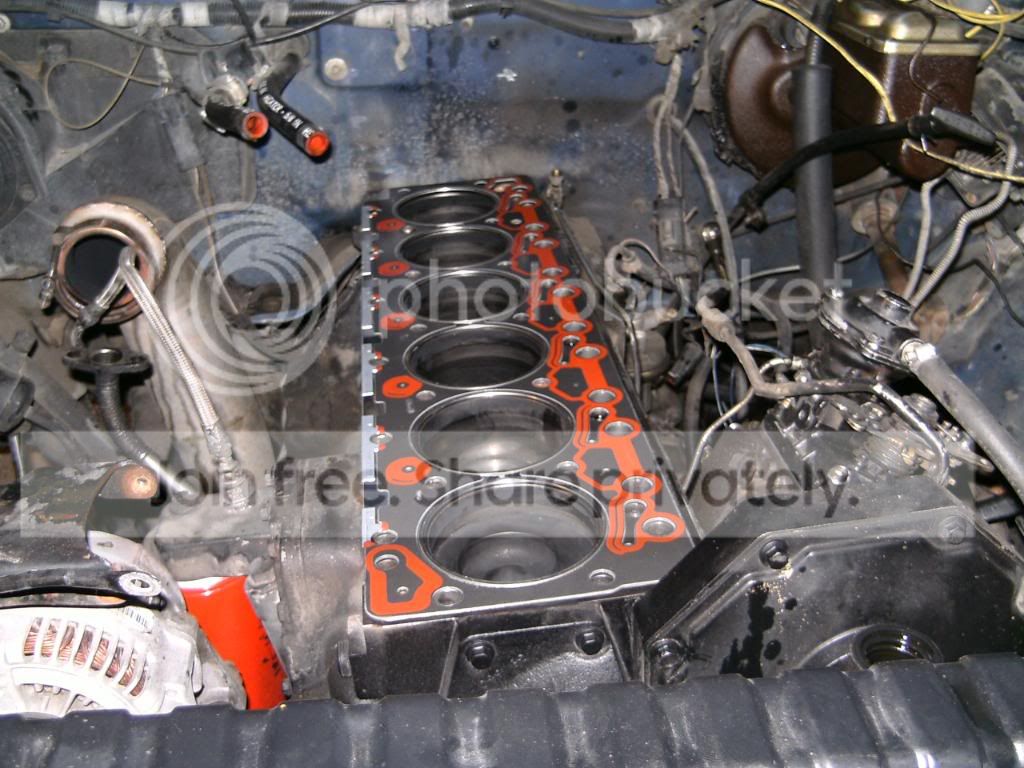

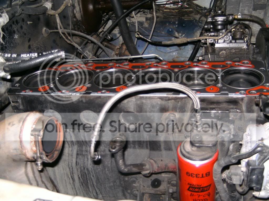

Old 11-29-2009, 10:31 PM   #71
pulltilbroke
Best Paint (Getrag category)
pulltilbroke's Avatar
Join Date: Dec 2007
Location: Eagle Ne
Posts: 1,118
Heres a few pics of the old gasket and whatnot
pulltilbroke is offline   Reply With Quote
