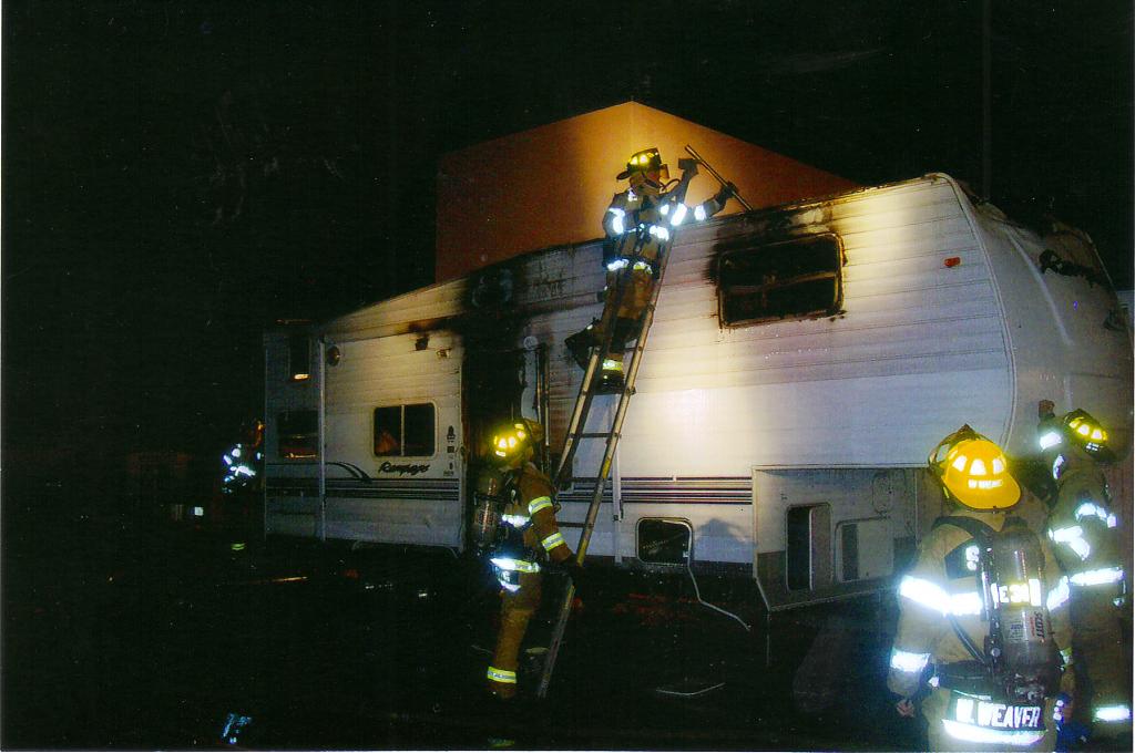

Wish I could have read this sooner. Just bought a new to me 2004 289 Rampage toy hauler had it two and a half weeks. Sitting in the parking lot with nothing on but the refigerator caught itself on fire and burnt down. Couldnt get any formal investigation insurance co just hauled it off and gave me a check. Makes me worry though my 9 year old son and I were going camping 2 days later.

I think Dometic waits for another unit to catch fire and when they find out they add it to the list. They are not handling this very well.

My rampage after 2 weeks
rampage pics
