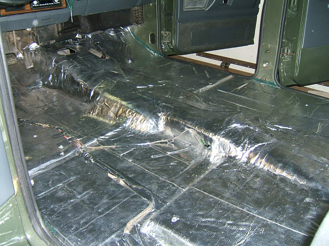

1985 Dodge Crew Cab
ACC part # 12011-80 Carpet or Vinyl
This Carpet / Vinyl is for the 1980 Dodge pickup crew cab 4 wheel drive
The truck I put it in is a 1985 Dodge pickup crew cab 4 wheel drive.
I got the Vinyl.
I'm happy with it the seats cover most of it.

use some more jute to take out all the ripels on the tranny tunnel vinly. other wise it looks good . i wonder if they make it for ext.cabs? i use jute to fill in the wrinkles in the vinly on anything ive ever put it in. just put u a couple layers of jute under the vinly on the tranny tunnel.
