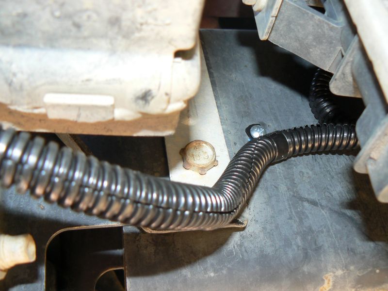

I got the cord from geno's and wanted to install it permanently instead of removing it in the summer. Since it doesn't have the fasteners like the Dodge cord, I used some plastic tubing, 1/4 inch plastic anchors and these cable clamps to fasten it in the stock holes in the frame.

you can get the fir tree wire ties here: https://www.cabletiesunlimited.com/
and an an12 wrench fits the nut.

Up here in the great white North we use the block heater a lot . One thing to do though is to plug it into an extension cord under the hood then run the plug for the extension cord out through the front. That plug is the one that you then plug your extension cord into. Why two extension cords? Well the block heater cords can get damaged up close to the plug from just usage but also pulling away when you are plugged in. The wire brakes internally and you don't notice it until it's cold and you can't get it started.
