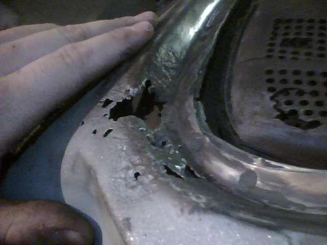

ok...after removed the front clip off the truck i was horrified with what i found! the first pic is beside the drivers side hood hinge, the second is the drivers side bottom corner of the windshield frame....after i tore the glass out!

so i did the right thing! i cut all the rust away and completely rebuilt all the rusty area......grounded it up and shot some primer on it.....i didnt pay much attention to makeing this look like nobody has ever touched it because its all completely hidden when the truck is together....so the cab is fixed as far as rust goes the cab corners and rocker panels are perfect..and even the passanger side windshield frame is too...

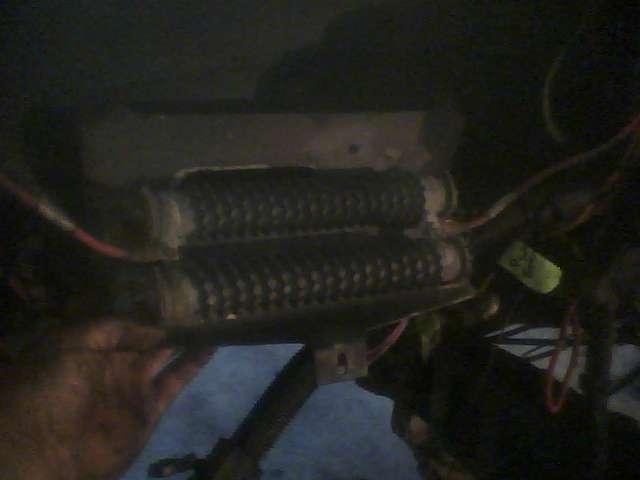

ok, here's a few most recent pics of the chevy.....the first one is the 6.2 diesel the TH400 trans and 208 tranfer on the floor and waiting for there new owner to come and pic them up!, the second is the chevy with the motor out and third is the chevy tore down just about as far as i'm taking it except the doors they have to be pulled soon....the last pic is something crazy i found under the hood....its got to have something to do with the glow plugs....lol this is a pic of it unbolted and flipped over it was mounted on the center of the fire wall....ill give a nickle to anyone that can tell me what that is

It looks like a set of resistors.
